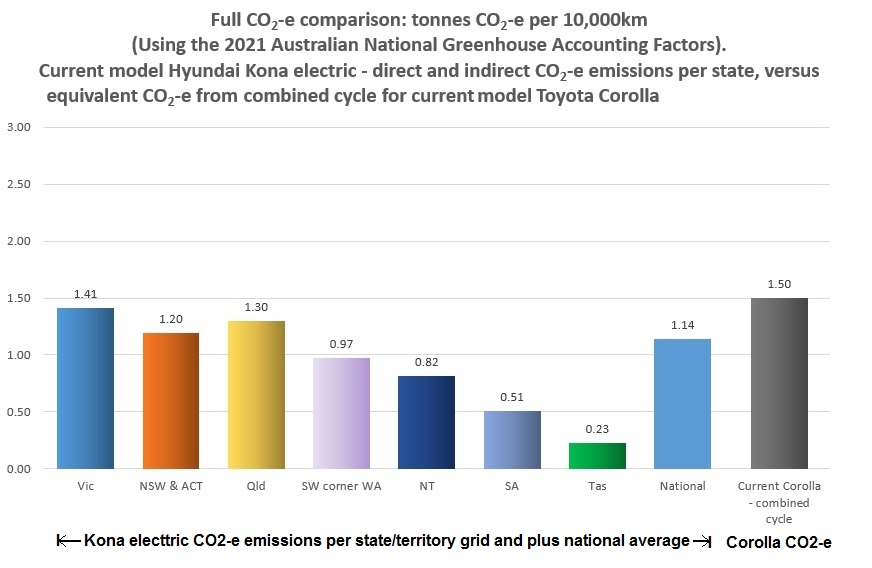

 First-up: I need to make the point that it is a mistake to directly compare new car petrol/diesel windscreen sticker CO2 emission numbers to EV electricity use emissions numbers – this is not an ‘apples-with-apples’ comparison.  Petrol/diesel windscreen stickers only show the direct CO2 emissions from the fuel burnt. They do not include the emissions due to extracting, refining, transporting and delivering that fuel to the car. They also do not include the greenhouse effects of gasses other than CO2. On the other hand, EV emissions data generally includes the warming potential of all the known greenhouse gasses, plus a lot of the downstream grid emissions – meaning comparing the two is not a true ‘well-to-wheel’ comparison of EV to ICE (Internal Combustion Engine). Graph 1 does give that comparison. The data is from the Australian National Greenhouse Accounting Factors (produced annually by the department of Industry, Science, Energy and Resources) and the calculations were made using the carbon emissions accounting methodology specified in that document.
 Graph 1-EV emissions article update
Graph 1: State/Territory CO2-e for 10,000 km. EV versus EV.
Comparison of full driving emissions for 2022 EV (Hyundai Kona electric) vs 2022 ICE (Toyota Corolla)

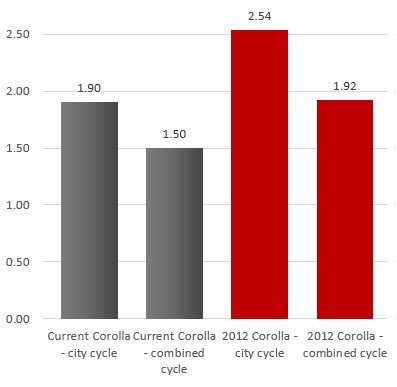

 Excitingly, now that the Victorian grid has progressed in reducing its overall emissions I can now finally say that in ALL cases, a new EV will produce fewer greenhouse emissions that an equivalent new ICE vehicle! Plus, given that ICE vehicles have improved their emissions over the years (Graph 2), replacing an older ICE with a new EV will make an even bigger difference.
 Graph 2-EV emissions article update
Graph 2: Full CO2-e for 10,000 km for 2012 Toyota petrol Corolla versus 2022 petrol Corolla.

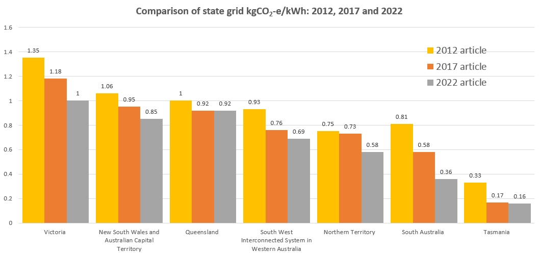

 The reason for this improvement in EV emissions? As can be seen in graph 3, in the last ten years all the states and territories have reduced their grid greenhouse emissions. (Although some have done better than others: Queensland being the stand-out failure with its emissions stuck at 0.92kg per kWh since 2015).
 Graph 3-EV emissions article update
Graph 3: Full CO2-e per kWh for each state over the last 10 years (
Note: data correct as of the article dates. The department does make retrospective amendments to the NGA tables, therefore the historical data given in the 2021 tables differs slightly to this graph.

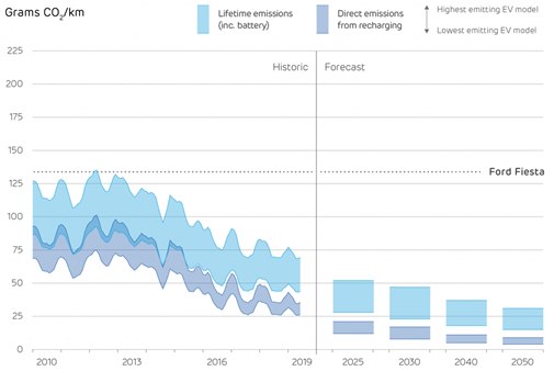

Having an EV produce fewer driving emissions is one thing – but does the inclusion of the emissions produced making the EV drivetrain (battery, motor and control electronics) negate that benefit?
 Again – numerous studies have now come out to say this is not the case. EVs generally repay that manufacturing ‘debt’ within a fairly short period, depending on the annual distance travelled. In Europe, based on the average European electricity grid emissions, it has been calculated the payback period for the battery manufacture is two years of driving, with an overall 50% less life-cycle CO2-e produced over the first 150,000 kmb. In the US, where cars generally do higher mileages, that payback period is around six to sixteen monthsc. Graph 4 is taken from a UK study that estimated manufacturing and driving emissions as the grid moves towards being fully renewably sourcedd.
 Graph 4-EV emissions article update
Graph 4: CO2/km for EVs using the UK grid 2010 – 2050. Source: ICCT.

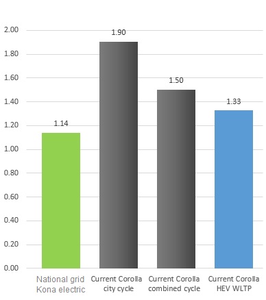

 However, to give some idea of whether HEVs are potentially a viable alternative, I have made a rough estimate in Graph 5 using the average WLTP figures for the HEV Corolla and Kona electric and the Green Vehicle Guide figure for the ICE Corolla. (Note, under the European WLTP test cycle, the Corolla HEV L/100km is listed as varying from a low of 4.4 to a high of 6.5).
 Graph 5-EV emissions article update
Graph 5: Tonnes CO2-e per 10,000km for Kona on national grid average, ICE Corolla (city and combined) and HEV Corolla
As can be seen from Graph 5 – the HEV Corolla rated on the more reliable WLTP test cycle is an improvement on greenhouse emissions from the petrol version, but it is not as large as an EV already offers. This is also based on the use case for the HEV being close to the WLTP test cycle conditions. Outside of that, its greenhouse emissions figure will increase. On top of that, local air pollution from the HEV’s tailpipe is not eliminated as it is from a BEV.
