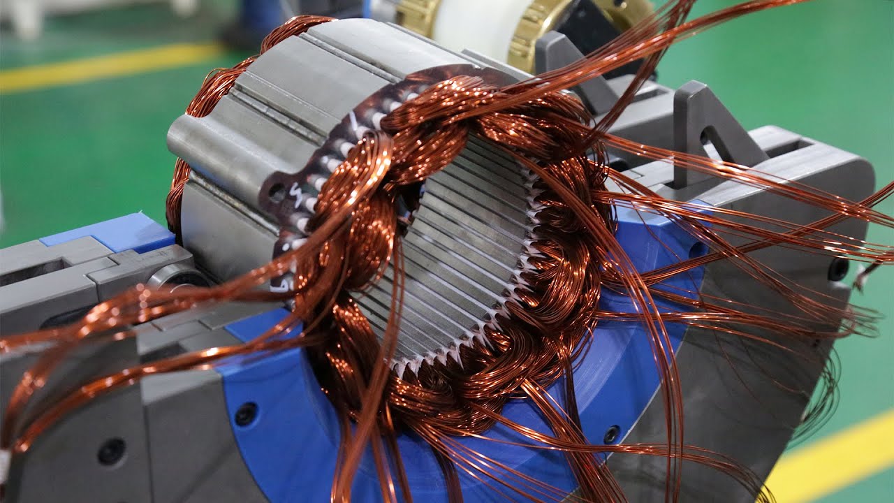

An EV takes about 25 % more energy, results in 30 % more emissions and takes substantially more material resources from the Earth’s crust than an equivalent-sized ICE vehicle. The two vehicles are effectively the same right up until the drive train is added – they both need wheels, a steel chassis, suspension, glass windscreens, air conditioning systems and plastic trims. Steel, aluminium and oil products are present in near-identical proportions. While the EV gets an electric motor stuffed with copper windings and a rotor with a few grams of rare earth metals, the big numbers are in the battery. Weighing up to 600 kg and consisting of a complex mixture of transition metals, polymers, graphite, copper and aluminium, the battery is where the bulk of 'embedded' energy and emissions stem from. These resources must be extracted from the ground and refined into useful chemicals. None of these processes could be described as impact-free; they still take energy, yields greenhouse gases and ultimately displace non-renewable elements from the Earth. It’s worth noting that all of these materials are recyclable, which we’ll get to later.
An EVs electric motor contains up to 10 kg of copper in its stator windings. The battery contains considerably more.

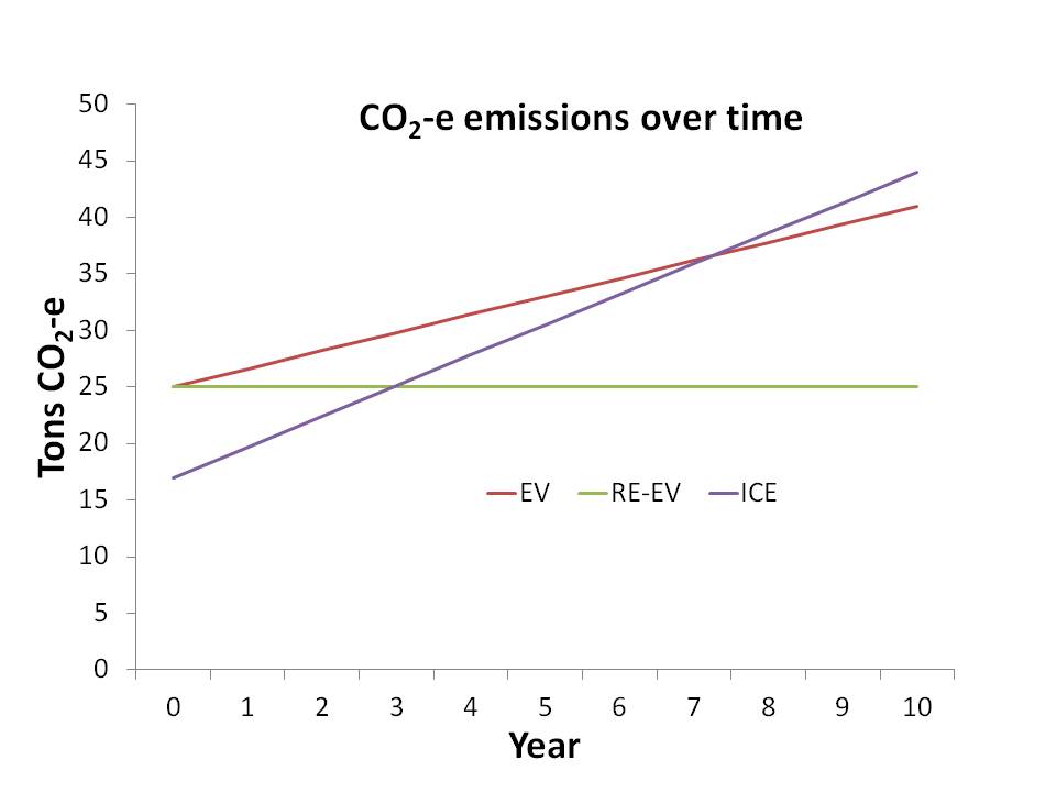

Considering the emissions of manufacture and those from operation over a 10 year period, the two vehicles can be compared. An EV charged entirely on Australia’s main grid with its current mixture of renewable energy and fossil fuel generators tracks a different path to that of a typical petrol vehicle. By year 8, both vehicles have emitted the same amount of CO2 as each other. But from this point on, the ICE car will continue to pollute. If the EV were to be charged entirely on renewable energy from day one, the chart looks even better with emissions equivalence reached after just three years.
Greenhouse gas emissions over time for an EV, an EV charged on 100% renewable energy, and an ICE vehicle.

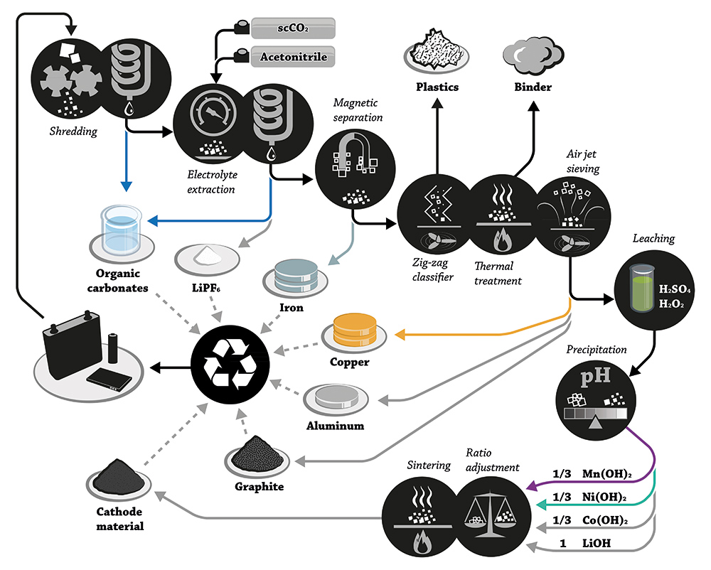

But sometimes the battery is no longer suitable for even home storage. The battery must be sent off for recycling. Li-ion battery recycling has been possible since the first cells were manufactured in the 1980s, but like most recycling it’s often not economically viable. The battery cells are not toxic in their final form and do not present a contamination risk in most municipal landfills. However this is a poor outcome, and should be discouraged. The battery still consists of valuable materials – steel, copper, aluminium, nickel, manganese cobalt and lithium. These elements represent battery chemicals which do not need to be dug up from the earth, and should therefore afford a convenient source for new battery chemical feedstocks. At the moment, lithium ion battery recycling as a business is still small scale, but it will soon become a critical component of manufacturer’s product stewardship.
Almost all materials may be recycled and purified to a point where they may re-enter the manufacturing process. Chemists are working on ways of recycling the battery in the most cost effective way. Most approaches involve shredding the battery to small particles, separating plastics from metals then separating the three main native metals (steel, aluminium and copper). The copper and aluminium fraction need to be cleaned of their anode and cathode coatings respectively, which is currently done by either ultrasonic agitation in water or by solvent action. Alternatively the aluminium may be dissolved in alkali and discarded. The cathode material is then acid leached, and precipitated to extract valuable cobalt, nickel and manganese hydroxide, which may be used as precursors for new batteries. Finally the remaining liquid may be precipitated to extract the remaining lithium in solution. Lithium is relatively inexpensive and abundant and this step may not prove viable. New cathodes are made in high temperature calcining ovens which is where the bulk of the energy and potential emissions stem from in battery manufacturing. If the electricity was sourced from renewable or low-emission generators, the impact is massively reduced.
Image from Rothermel, S.; Evertz, M.; Kasnatscheew, J.; Qi, X.; Grützke, M.; Winter, M.; Nowak, S. ChemSusChem, 9, 3473-3484 (2016)
