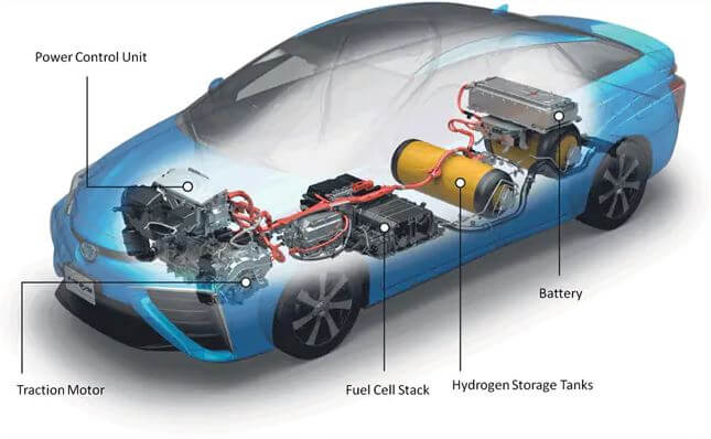

A Fuel Cell Electric Vehicle (FCEV) just has a fuel cell to provide the electricity for the motor rather than a large battery charged from the mains. It would generally have a small battery to buffer the peaks since fuel cells are not very good at short bursts of power. They would prefer to tick along at a lower rate meeting the average demand of the motor. In that respect they are much like a petrol hybrid - the petrol engine can run a generator at a more constant rate and a small battery alternates between provide the extra power when required or soaking up the excess power from the generator in between the bursts of acceleration or hills.
