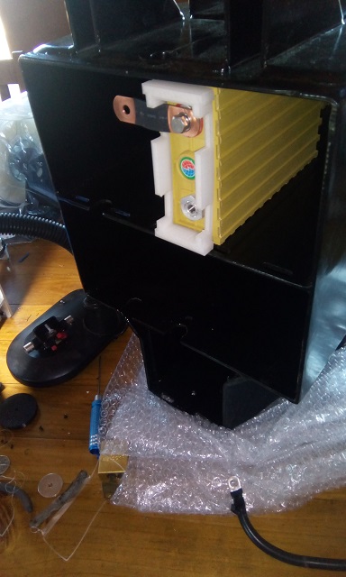

Battery: Nominal 72 volts (23 series Winston 90 Ah capacity)

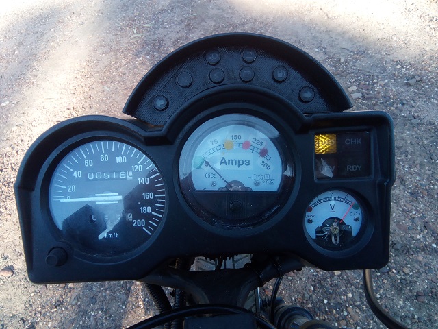

The battery is monitored with a ZEVA cell monitor. If one cell goes overvolt the charging process gets stopped.
Over/under-volts are displayed in the dash. Battery balancing is done externally. After a settling in period of a few charge cycles the battery was bottom balanced and is performing well since. Winston 90Ah battery stays always cool....no matter what I do. I use only 80% of the rated capacity (90 Ah) keeping clear of bottom and top voltages to increase the life of the battery (2.5V -3.8V).
