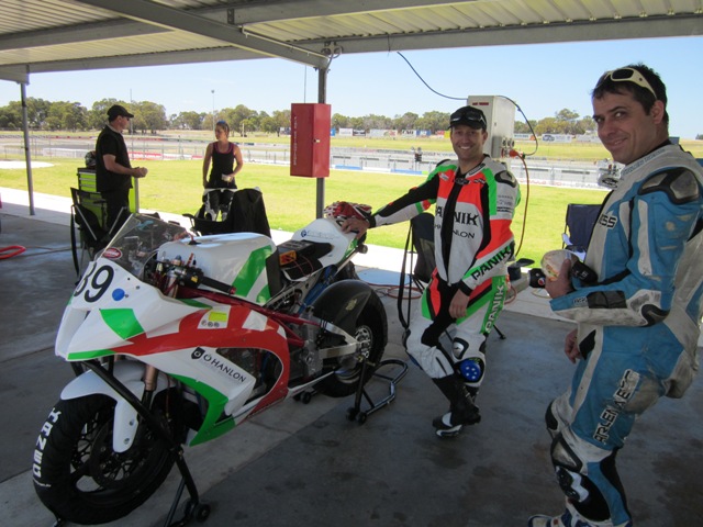

Danny Pottage with Voltron Evo at Barbagallo Raceway.
Voltron Evo was piloted by Perth road racer, Danny Pottage (aka Pottz) who took the bike with virtually no baseline suspension settings and set about making it remotely rideable. He took first place in all 4 races at Queensland Raceway in it's inaugural eFX competition against several other electric motorcycles, including bikes built by Danny Ripperton, Jon Eggenhuzien and the team at Varley Engineering.
